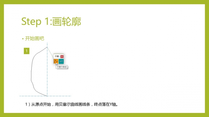

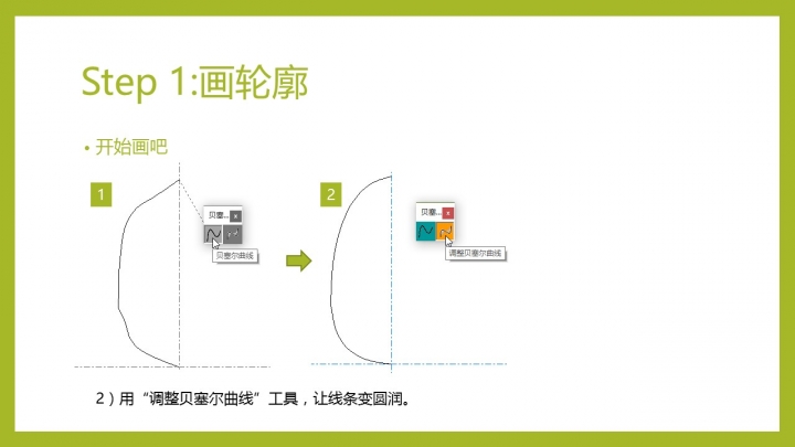

28963
发表于 2016-3-9 22:29:44 | 显示全部楼层 |阅读模式

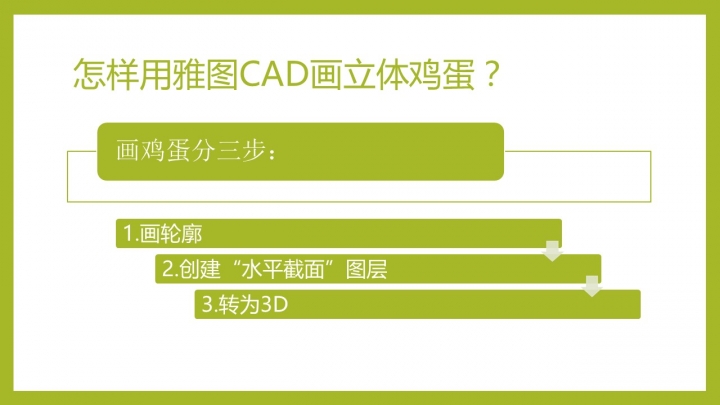

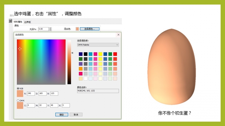

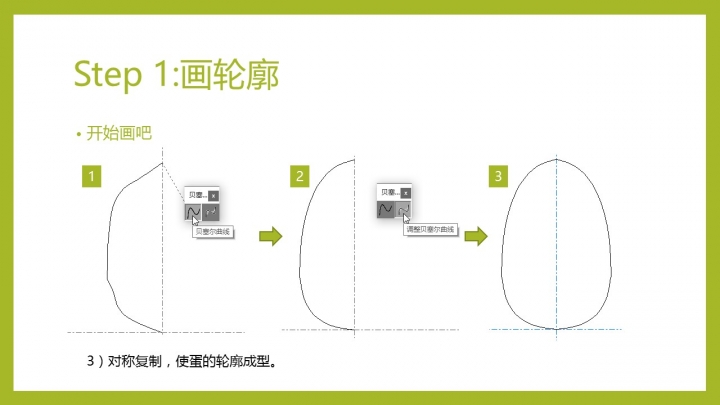

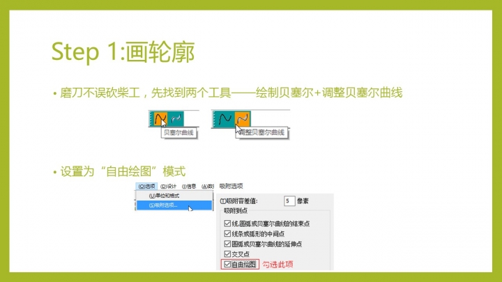

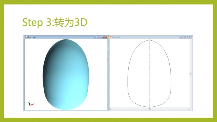

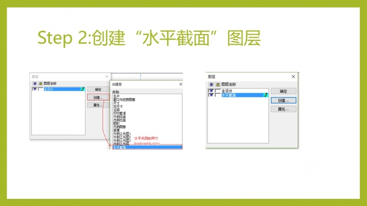

首先说明下,本文作者是wolfshawn大师,后面他跟帖,想感谢他,在他帖子上评分打赏哦
正文如下:
幻灯片1.JPG 幻灯片2.JPG 幻灯片3.JPG 幻灯片4.JPG 幻灯片5.JPG 幻灯片6.JPG 幻灯片7.JPG 幻灯片8.JPG 幻灯片9.JPG 幻灯片10.JPG 幻灯片11.JPG 幻灯片12.JPG

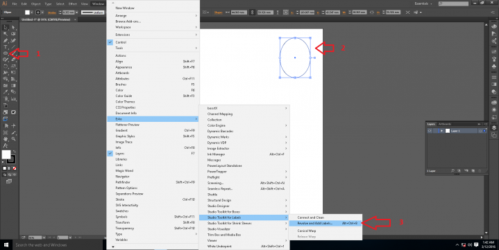

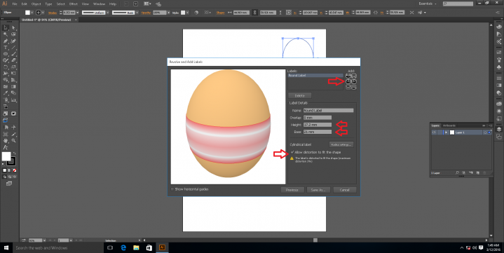

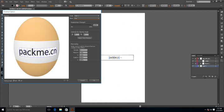

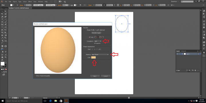

Then there's the 'easy way', with Esko Studio Toolkit for Labels and Illustrator as I posted here
1 - draw an ellipse with the 'Ellipse Tool (L)'
2 - adjust as you wish
3 - go to Window>Esko>Studio Toolkit for Labels>Revolve and Add Labels...
Adjust the color, material and mesh quality.
Add labels if you wish.
Customize your eggs, etc!
cheers
